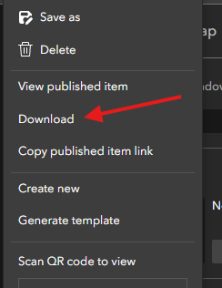

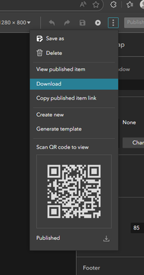

You have two options, in the application click the 3 dots on the upper right an chose download
Or on the main page click the 3 dots then download

@JoshuaSoukkala I think the difference is that my screenshots were from Experience Builder Developer Edition and yours are from AGOL. I just checked some EB apps on AGOL and Enterprise and you cannot download from there. It looks like the only way is to configure your app in Developer Edition and download the ZIP from there.

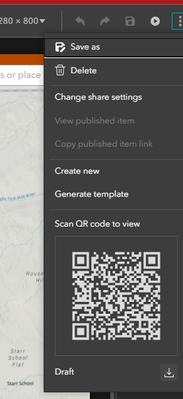

so you don't see an icon like this?
I will admit I just now saw that icon myself.  I don't know what version this portal is on currently
This one looks like no changes have been made and its just a draft though

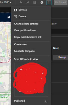

in another one I saw this:

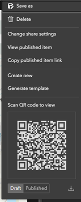

In one other experience on AGOL i saw something like this:
Save as I know is just creating a fresh experience from it with a new name in AGOL  The only difference between the first one and second one and this one that I can tell is one is a private company AGOL experience, and the other seems to be public facing.  I believe the other one is public facing, which leads me to believe, that something about how that version is configured effectively does not provide permission to download it this way. (Even though both are AGOL)
Do you see something more like 1 or 2 or 3?
IN the first two that icon which I'll crop out: after interacting with it, it only downloads the QR Code (which is new to me I hadn't seen that before), which I think proves your initial observations.
