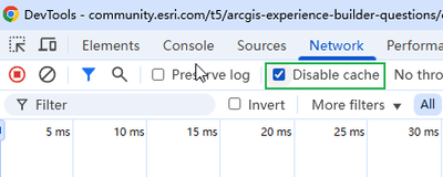

I think you don't need to restart the server. You can try Ctrl+Shift+R to clear the cache, or disable the cache in DevTools Network(remember to uncheck it when you're not developing).
Re-adding a new widget is inevitable because the default settings defined in config.json are applied when adding a widget.
