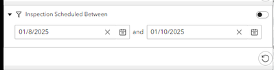

I've deployed my application to IIS server and seems like the date format inside feature info, table and date component all not using en-GB date format.
However, in local pc EXB dev edition the app shows en-GB date format. I did open the web map layer via portal map viewer. The popup and table do follow en-GB date format.
I've already update IIS language and date settings but still can't change the date format of the app.
Is there any extra configuration to be done if the application being deployed in IIS? FYI, the web server can't access public web. Not sure if this causing the issue.

DateTime. That UI component coming from filter widget.
We did not configure any format when we deploy the feature layer from ArcGIS Pro. So, I'm assuming it will take account device datetime format.
