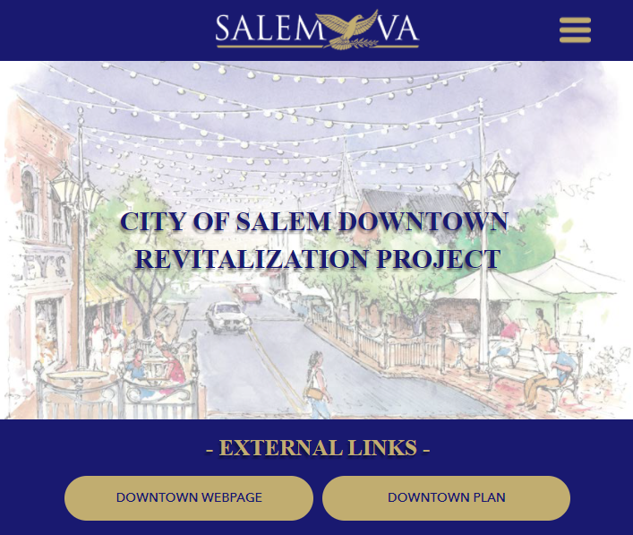

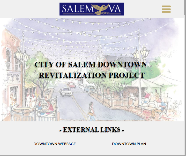

I have created my first web application using Experience Builder and have run into an issue. Using my organization's colors is not an issue in Experience Builder, however when I publish it and make it public, I lose my entire color scheme. Please see images below. The first is from the preview window in Experience Builder and the second is what the application looks like once made public. I have attempted to change several setting such as organization theme and custom colors and nothing has allowed publicly view the app as I designed it.

Unfortunately, you discovered a bug with the organization theme color not available for public use. I will log this and will get it fixed. Can you use the more option in the color component to use the same HEX as your organization theme as a workaround for now?
