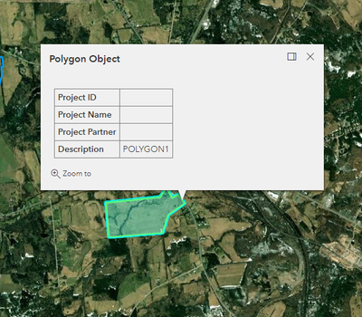

Hi Raena.  I implement a point, line, and polygon feature layer in my map.  These were very simple geometry layers I created in AGOL, which I then added to my map.  When I click on a polygon that is part of the polygon-related feature layer (see below) it highlights, a pop-up comes up, and I can go to "Zoom to" in the popup to zoom to it.  I know it may not be an ideal work-around, but have you tried configuring your feature layer to have a pop-up?

No, I don't mean this, and as I understand, a feature layer cannot support multiple geometry types.  That being said, what I would do in AGOL is configure a very simple pop-up for the polygon layer.  The pop-up can be very simple and display some attribute.  Doing so, in your web app, if you click on the polygon, you will get the pop-up and should see the "Zoom to" icon, like I demonstrated in the image I attached earlier
