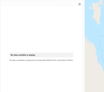

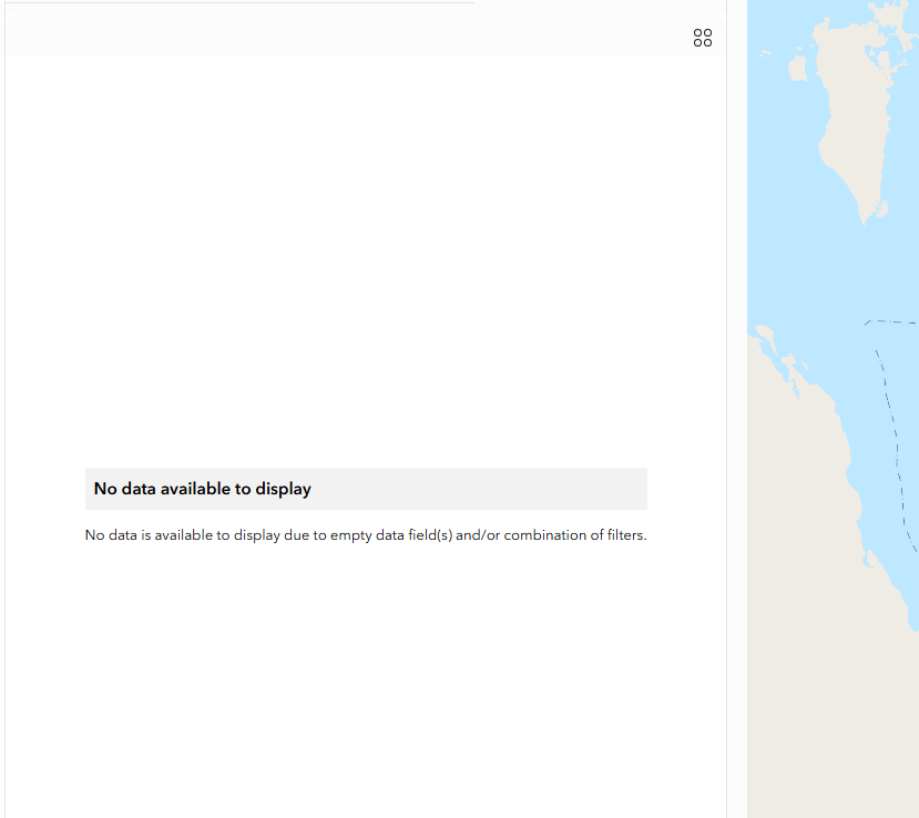

I have developed an ArcGIS Experience Builder app and added charts that are linked to the map. However, after publishing the app, the charts do not load on the initial attempt. They only appear after refreshing the page or when a feature is selected on the map. The “View from empty selection” option is already enabled.
The Problem
I have several Chart widgets in my experience that are linked to a map. When the app is first opened, the charts appear empty or stuck in a loading state.

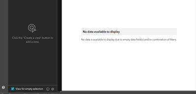

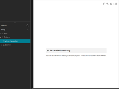

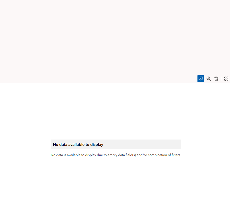

FarrukhZahid
I have tested this on multiple datasets, different layers, and even using different ArcGIS Online subscriptions. However, the result remains the same. It seems this might be a tool-related issue, where the tool loads before the data becomes available.
Additionally, I tested the same scenario in the local (Developer Edition) Experience Builder environment. I added my layers and created a chart. When I selected “Select features” and enabled “View for empty selection,” the chart did not appear. However, when I switched the selection option back to the default data source, the chart displayed correctly.
After publishing from my localhost, the chart did not appear initially. However, once I refreshed the page, the chart displayed correctly
Below is a screenshot from the localhost Experience Builder.
