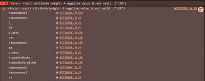

Hi everyone,
I have developed an ArcGIS Experience Builder app and added charts that are linked to the map. However, after publishing the app, the charts do not load on the initial attempt. They only appear after refreshing the page or when a feature is selected on the map. The “View from empty selection” option is already enabled.
The Problem
I have several Chart widgets in my experience that are linked to a map. When the app is first opened, the charts appear empty or stuck in a loading state.
Interestingly, they function perfectly fine if I do either of the following:
  • Refresh the browser page after the initial load.
  • Select a feature on the map (which triggers the data link).
Current Configuration
  • "View from empty selection" is already enabled for all charts.
  • The charts are using the same data source as the map layers.
  • The app is published (the issue persists in both the published URL and the builder preview).
I’ve tried toggling the "Selected features only" filter and double-checking the data source triggers, but the initial "cold start" of the app still fails to render the data visually. It's as if the data source isn't "waking up" until a secondary interaction occurs.
Has anyone encountered this specific behavior? Is there a known bug regarding the initialization of charts in certain layouts, or perhaps a specific setting I'm missing to ensure the charts populate immediately upon the first visit?
Any insights would be greatly appreciated!

FarrukhZahid
Hi JavierML,
Yes, I’ve already tested several times in different browsers and also in incognito/private tabs, but I’m still facing the same issue. I even noticed this error directly in Experience Builder: when I opened the app to edit, the chart wasn’t loaded. After checking the data source, I saw it was marked as an empty selection. Once I unchecked and re‑selected it, the chart appeared again.
This is a completely different behaviour, and it’s inconsistent across my apps. I have more than 70 different Experience Builder apps with various maps and charts — sometimes a chart loads, sometimes it doesn’t.

For troubleshooting purposes, could you open the Developer's console and look for errors both in console and Network? Maybe it can say, where and when the error appears (maybe it's the tool, maybe it's the connection to the data).

FarrukhZahid
I have tested this on multiple datasets, different layers, and even using different ArcGIS Online subscriptions. However, the result remains the same. It seems this might be a tool-related issue, where the tool loads before the data becomes available.
Additionally, I tested the same scenario in the local (Developer Edition) Experience Builder environment. I added my layers and created a chart. When I selected “Select features” and enabled “View for empty selection,” the chart did not appear. However, when I switched the selection option back to the default data source, the chart displayed correctly.
After publishing from my localhost, the chart did not appear initially. However, once I refreshed the page, the chart displayed correctly
Below is a screenshot from the localhost Experience Builder.
Screenshot 2026-05-14 091756.pngScreenshot 2026-05-14 091756.pngFarrukhZahid_0-1778738822977.pngFarrukhZahid_0-1778738822977.pngFarrukhZahid_1-1778739640230.pngFarrukhZahid_1-1778739640230.pngFarrukhZahid_2-1778744967808.pngFarrukhZahid_2-1778744967808.pngFarrukhZahid_3-1778745000549.pngFarrukhZahid_3-1778745000549.pngFarrukhZahid_4-1778745027014.pngFarrukhZahid_4-1778745027014.png
