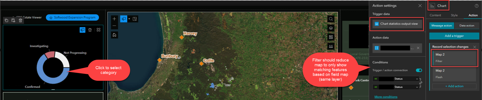

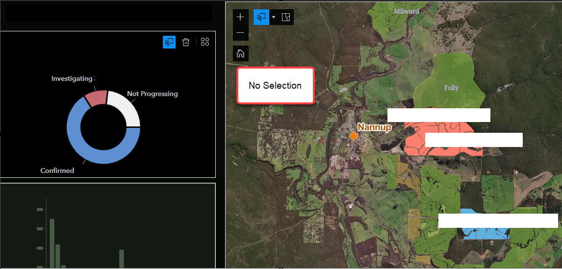

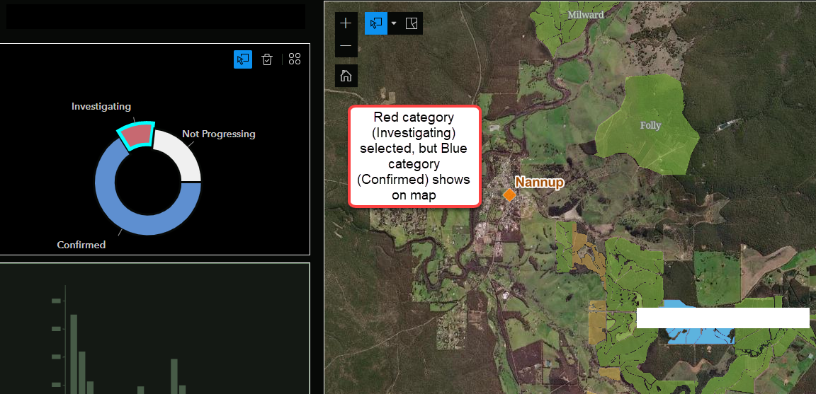

I am building a dashboard style display in Experience Builder that shows features in a map, and provides basic charting and filter functions. The layer of interest in the map is also referenced in a pie chart on the side of the dashboard. When you click one of the feature categories in the chart, a Filter Action is supposed to reduce the features displayed in the map to only show those matching the selected category. However, whenever I select it, it seems to pick a different, random category. I've recreated the chart and the action multiple times but can't get it to behave as it should. It doesn't seem like a complex setup, so what is going wrong?

TonghuiMing
FYI - per preliminary investigation, this is a different issue.
This case has something to do with grouping either categories or values to use in the chart component - which causes the index mismatch between the selected chart section vs. the actual selected features. If there is no grouping configured (as in my previous case), this issue wouldn't occur.
We will follow up on this.
TonghuiMing
@JennetteDuncan - the mismatch you encountered before related to grouping should be resolved in the latest 2023 AGOL Oct release. Let us know if you encounter any other issues. Thanks!
