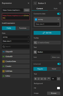

Hi,
I'm trying to use a button to link to a URL and pass a value from a data source.  I'm struggling to find any documentation on how to do this, and my random guesses at how to build the expression are not fruitful!
Could anyone point me in the right direction?
Many thanks,
Helen

You have to put that first bit in quotes.
"https://mapitout.co.uk/" + {globalid}

HelenCooper
Thank you @jcarlson , that sorted it - really appreciated!
