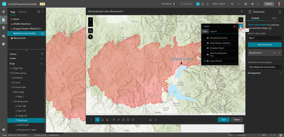

We can toggle layer visibility when setting the bookmark location:
Somehow all layers were hidden in this setting for some of my bookmarks (not by me directly), but they can be changed back to visible and seem to stick.
