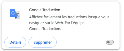

Bertrand_Laurancin
You can try to disable Google Translate :
