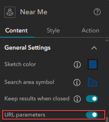

This issue seems to be url parameter support issue. Near Me supports url parameters.  If you have a selected feature or features and NM is present the app , it runs automatically. We are planning to add a setting in February update (2026)  like Search and Map widget. When the setting is enabled,  url parameter will work otherwise it won't.  So after the update (I will reply here) you can use the new dev edition 1.20 (should be out in March) to control this behavior.

Hi @erinorourke23  if you have a selected feature and Near Me is open, Near Me will run the analysis based on the selected feature because of the url parameter support, this behavior is as designed, however we have added a configuration in the February 2026 update to turn the url parameter off. If you do not need url parameter, you can turn this off and it will not run automatically when there is a selected feature, by default the option is on. You will get this configuration with Enterprise 12.1 under General Settings
