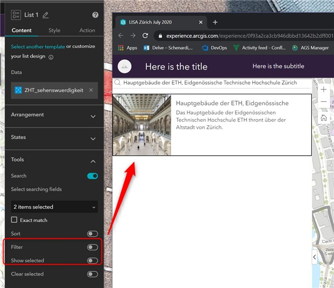

I do not understand the search settings in the list widget of the experience builder‌.
I switched off the Filter and Show Selected setting but the result is a filtered list.
And by the way: there is missing a "clear" control like an x or something to return to the full list of items.

Thank you for mentioning the "clear search" control, this would be considered in the next release. Currently, you can clear search by deleting all text in the search box, but I guess this is not very obvious.
For the filtered list, do you mean that when use the Tool search, results should only be selected and highlighted, but not filtered?
