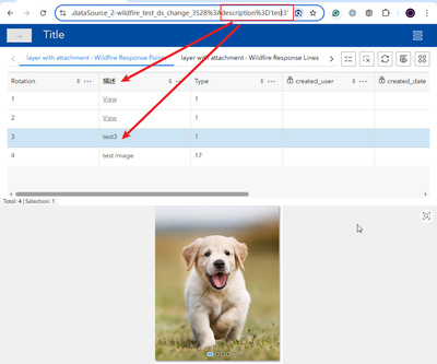

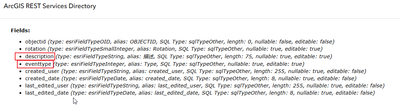

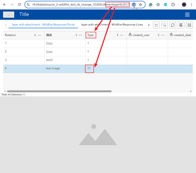

Allen_Zhang
Sometimes the displayed field name is not the real field name...
You can find the real field name here in arcgis rest service.
And if the field is a text/string, you need to wrap the field value with single quotes:

Allen_Zhang
