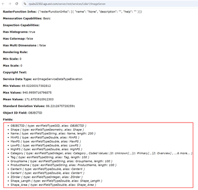

Hi @AngieCausey ,
Please check the imagery service, if there are any fields in Fields. We found a bug earlier that was related to this.
If there are fields in the service, could you share the imagery service to help us continue troubleshooting, thanks.

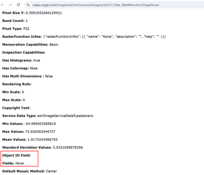

Thank you Ke_Xu for your response.  The service does not have any fields.  Here's the link: https://maps.scpgis.com/imagehost/rest/services/Imagery/stch21_lidar_WebMercator/ImageServer  I believe you should be able to access it.

Hi @AngieCausey ,
There is also no fields for a (dynamic imagery) layer.
The bug has been logged as BUG-000169365 and it will be released soon.
