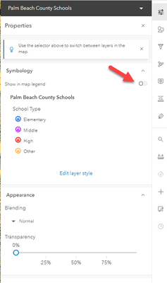

I turned my show legend off in map viewer and the legends for those layers don't show in EB print results.

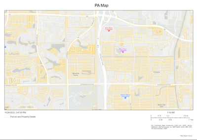

Also, for customization, do you mean the look of the map and what appears? Because that depends on the print service you're using.  You could make a custom print service to format the map how you wish, but if you use the built-in print service you get a map similar to my picture above.
