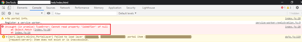

Created an experience using launchpad template, added a WebMap from ArcGIS Enterprise. Published, downloaded and hosted the experience in web server. Updated clientId property in config.json.
When opened the application in browser, observed an error in the browser's console. Please refer to the enclosed screenshot.

I forgot to ask you did this error prevent you from logging into your experience?

No, this error did not prevent me from logging into my experience.

That is good to hear. I was able to reproduce this as well. I logged it as an issue and will fix this error message.
