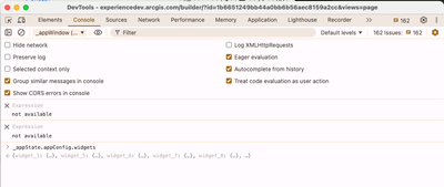

As for finding widgetId, there's no way to find it in the builder. You can find it by going to the developer tool console. Just run _appState.appConfig.widgets, you will see the list of widgets printed:

Hi Shen, Is developer tool console that you are referring to the same as the console under "Inspect" in Google Chrome? I'm having trouble finding where to run _appState.appConfig.widgets. I greatly appreciate your help!
Shen_Zhang
Yes, but please go to the "Console" tab and enter _appState.appConfig.widgets. When inspecting something on the page the DevTools should open "Elements" by default. The "Console" tab is just next to it.
Shen Zhang
Matthew_Deveney
Thanks Shen, I was able to find it. Much Appreciated!
