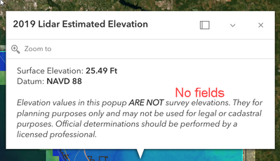

I have a webmap that contains a hosted feature layer, many image layers, and 2 Digital Elevation Model (DEM) layers.
The image layers are sourced from image services created from mosaic datasets.  The DEM layers are sourced from image services, but created from simple raster datasets so that I can take advantage of the raw pixel value to display in my popup.
As with @AnninaRupe1 , the popup will display the info from the hosted feature layer, and the popup indicates the DEM.  But no popup will remain on screen for the DEMs.  Just a spinning gif that then disappears.
The webmap has no issue displaying the popup from the DEM.

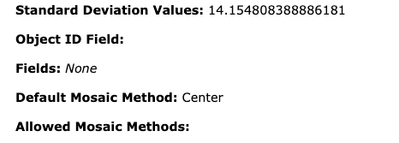

The target layer is a dynamic imagery layer type, however, the specialty about it is that it does not contain any fields - no OBJECTID either
TonghuiMing_1-1723621740510.pngTonghuiMing_2-1723621754462.pngTonghuiMing_3-1723621817672.png
Our map widget has the logic to check and sync with the data source selection (so that in regular cases, other widgets will be able to use these selections), and OBJECTID being null has caused the check to fail. Thus, you will see the loading and then flash behavior.

"The target layer is a dynamic imagery layer type, however, the specialty about it is that it does not contain any fields - no OBJECTID either"
- this is normal for a dynamic image service sourced from a file geodatabase Raster Dataset.   This is the only way to get at the service pixel values.
Clearly, the JavaScript 4.x api recognizes and interprets the pixel values from the image service as fields that can return values, the {Raster.ServicePixelValue} and the {Raster.ServicePixelValueRaw}:
And so Instant Apps or a custom JavaScript 4.x app with Calcite components have no problem returning these values.
But yes, like @AnninaRupe1 - we need this capability in the ExB and it was there.  I could see in the Console log that something was 'missing fields', and I assumed that was the raster datasets.  What happened?
