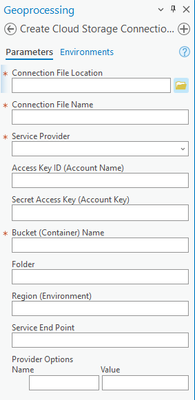

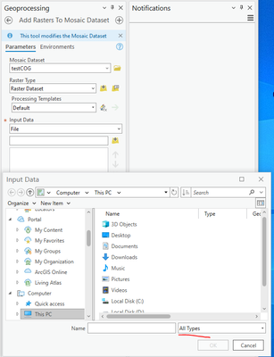

For COG data, you can use the GP tool 'Create Cloud Storage Connection' to create a connection file.
After that, create a mosaic dataset and add rasters to it, selecting the connection file as the input data source. Ensure you select 'All files' when browsing for the connection file.
Fields and attributes will be generated automatically. Finally, publish the mosaic as a service. Hope it helps!
