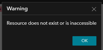

Today I went to edit my ExB, however it has gone blank with all content gone and the following error. I haven't touched this ExB since last editing it and have had no issues.
The ExB is still viewable on the published link, but I cannot access it in the edit mode? I have already closed and refreshed so cannot go back and save as a new ExB (it gives a Save As error). Is there a way to recover this please?!

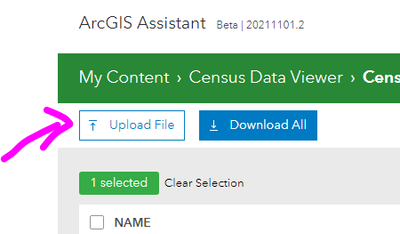

5. After this is deleted, click upload file, and upload the .json file you saved with the original Experience Builder config

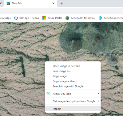

4. If the original app is still working ok, open a Chrome Browser or Edge or Firefox.

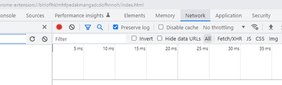

5. Right click on the browser and select inspect to open the dev console.
6. Select the network tab.
7. With the same window open, paste in the URL to the app ( not the new one we created, but the one you want to recover).
8. Once its loaded go back to the dev console and filter on data. There might be multiple entries, but it should be the first one. Click on the names to check the response. You want to find the one that has the app config, it should look like the below. With {"pages":{ etc

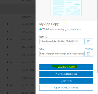

10. Find the new app that we created at the start, click it and then select View Item JSON

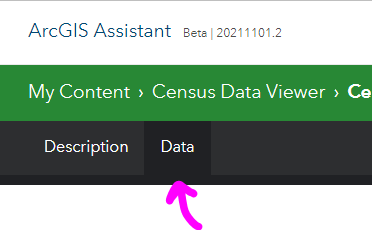

11. Select the Data tab
