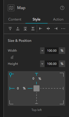

But for the map, do you by chance have percentages set for it's position? Click on the map, and go to the "Style" tab (see below). Anything that isn't similar to "100%" width/height and "0%" position will move with the page. Absolute units will work as well, but it depends on your use-case.
EDIT: That moves more than I was thinking... Have you checked your Experience's "mobile" and "tablet" versions? Use this switcher in EB (see below). Desktop mode doesn't work on mobile devices (due to screen size).
