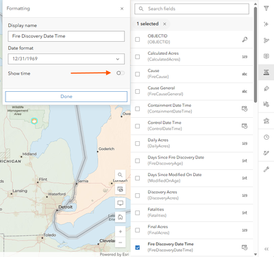

@StephenKing3, if you don't need the time somewhere else and the layer is housed in a web map, you can just change the "show time" setting for that field in Map Viewer:

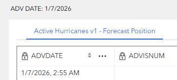

I actually can't get the time to display at all though (in 11.5), so I'm curious what the difference is between our setups. Text widget vs the table widget:

My setup is pulling in data from a feature layer generated from a Survey123 survey form. I'm not trying to display any features in the map from this, just pulling in tabular data. Thanks for the pointer to the 'show time' setting for the feature layer. You can change this for the layer visualisation and save it, but it doesn't appear to make any difference in pulling in the data field in ExB.

Ah man, that's frustrating. For anyone who happens to see this and is working in ArcGIS Online, changing that setting in Map Viewer does work to stop the time from displaying. Maybe it's a bug? I found something that seems related, found in 11.4: "The ArcGIS Experience Builder Table widget fails to hide the time for a date field when 'Show time' is disabled on that field, and the list of fields for the widget is customized." BUG-000174261 for ArcGIS Experience Builder
