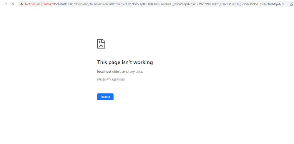

Friday afternoon, I was able to export/download Application packages to put into our hosting environment. I have updated nothing and didnt touch it since the last successful download Friday afternoon 3pm.
Exporting a new edited today, I invariable get "Not found" error or

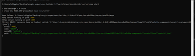

And my Server command throws weird errors:

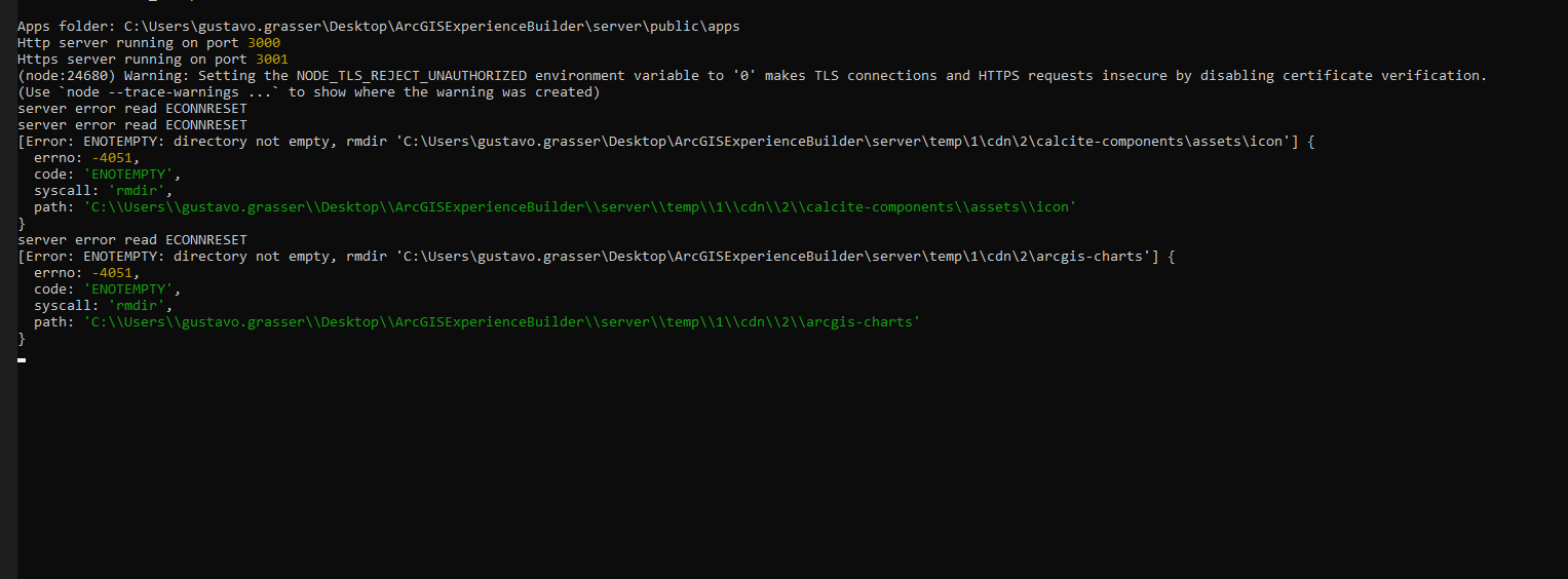

I dont even know why. One our our technicians, separate environment (local 1.9 dev) gets the same error when exporting, or a variation:
So obviously something major is going on with the dev environment. This is putting us seriously behind on our development cycle when we cant even export versions into our test host environment. He exported a version this morning no problem.

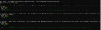

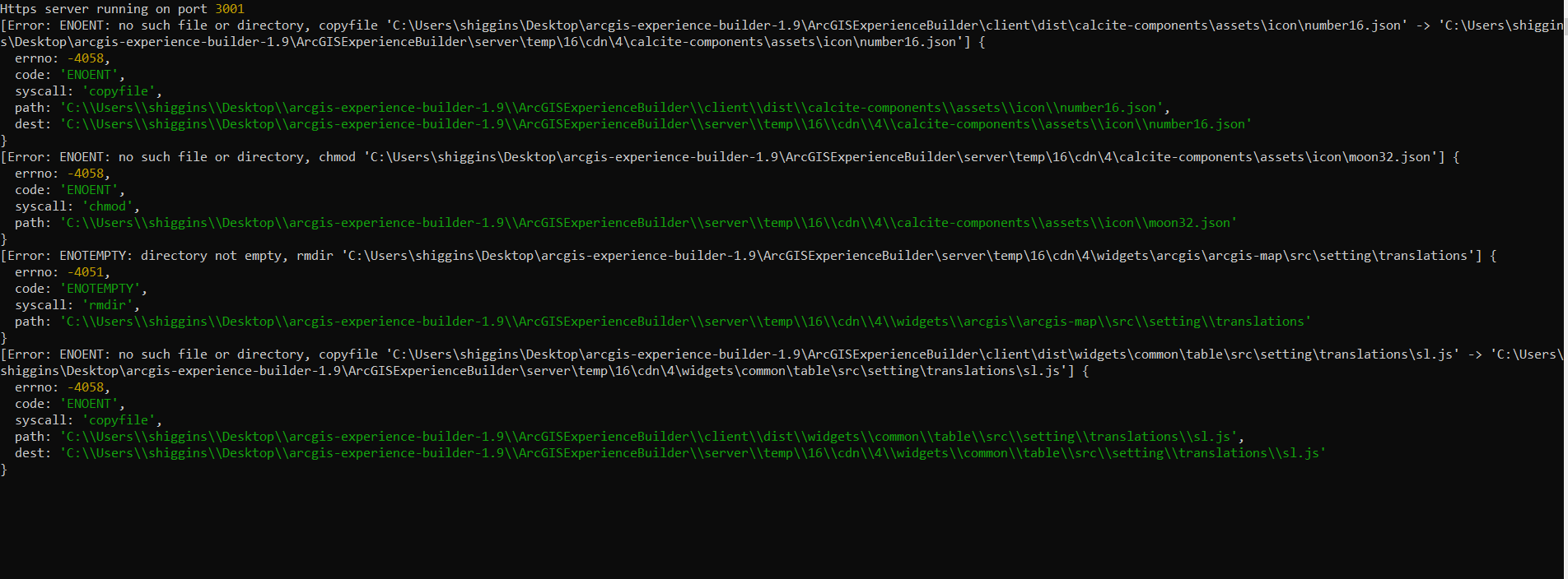

Well, still broken today for two of us. It seems to be populating icons and something to do with calcite components, which isnt even referenced or used in apps:

@ScottHiggins_PVGIS  We have Esri support ticket open but not much progress.  I am trying to narrow down the possible cause:
  • Which OS do you use?  I am on Windows 10 and not experiencing the issue, while another developer in our organization is on Windows 11 and experiencing this issue.
  • Do you happen to use `@arcgis/core` module in your custom development?
  • Do you happen to have a folder named "tests" anywhere in the custom widget(s) you wrote?
