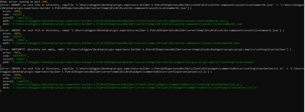

Not sure if anyone else is experiencing issues out of nowhere with their 1.9 Dev Experience Builder environments. But two of us are having the same issue in separate environments.
Friday afternoon, I was able to export/download Application packages to put into our hosting environment. I have updated nothing and didnt touch it since the last successful download Friday afternoon 3pm.

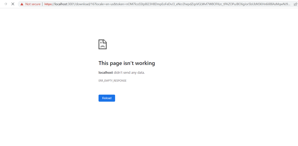

Exporting a new edited today, I invariable get "Not found" error or

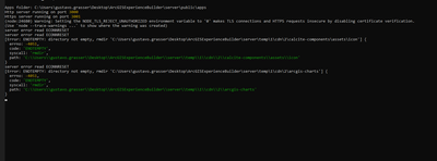

And my Server command throws weird errors:
I dont even know why. One our our technicians, separate environment (local 1.9 dev) gets the same error when exporting, or a variation:
So obviously something major is going on with the dev environment. This is putting us seriously behind on our development cycle when we cant even export versions into our test host environment. He exported a version this morning no problem.
