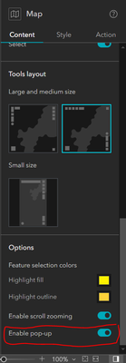

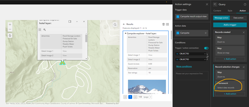

To achieve this, you will need to:
1. Use the message action, to trigger the selection of a Query output result to the selection of the original data sources
2. Inside the Map widget, turn on this option

So far, this does not work for me, but I do not have the option shown in your screenshot below "Enable pop-up" to "Show pop-up upon feature selection":
JeffreyThompson2
MVP Frequent Contributor
That option is an Experience Builder 1.13 addition. Enterprise 11.2 is running Experience Builder 1.12.
You'll need to wait for the next Enterprise update or switch to Developer Edition.

I see. To be clear, this option will allow me to click on the features within the map and show the pop-up for the query results layer (not the original layer)?

Clicking on results in the Query Widget should trigger a popup on the map using the procedure described above.
The Query Widget does not create a seperate layer. The Records Selection Changes > Framework > Filter Data Records Action can be used to filter out all of the features in the original layer that do not meet the query criteria.
