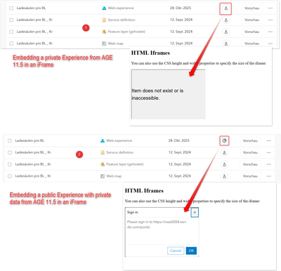

NiklasKöhn
Hi @ShengdiZhang @Wei_Ying ,
the issue seems to be resolved in ArcGIS Online (see screenshot below).
However, it still exists in ArcGIS Enterprise 11.5, as demonstrated in the 2nd image below with an Experience created with the embedded Experience Builder in ArcGIS enterprise 11.5 and an iFrame on localhost.
What is the first Experience Builder version that contains the bugfix? Should be higher than 1.17, because that's the version included in ArcGIS Enterprise 11.5, according to the release versions list.
Or is it not actually a code issue in Experience Builder, but more of a web server setting? If so, would that be something that admins can fix themselves in the ArcGIS Enterprise?
Wei_Ying
"However, it still exists in ArcGIS Enterprise 11.5"
For a released Enterprise version, the fix won't be up-to-dated, unless user requested a hotfix through patch.
This fix should be available in Enterprise 12.1, latest Online edition and developer edition 1.19.
