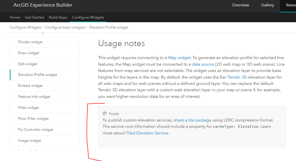

This is still the issue a year later and I have been using the document you linked too to create my own custom tile. Is this something you could add to the documentation since it might help others?
AlixVezina
@sigccil  Yes, that's a good thought. Following this original report, we've added a note in the documentation with these resources: Elevation Profile widget—ArcGIS Experience Builder | Documentation
