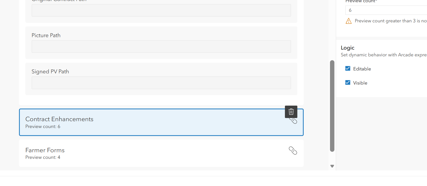

I can't use the Editor widget to add related records to an attribute only table. The form is configured correctly in map viewer. (Editor.png)
The "add records" section just disappears in the Attribute Only Editor widget-so there's no way to add the repeat records. (Editor1png)
The Attribute with geometry option in Editor just shows my related polygon feature layer. So there's no access to that parent non-spatial table. (Editor2.png) In my polygon feature layer, I can add records to the related table... (Editor3.png).

Your contract enhancements are configured under the main layer, as shown in your Editor screenshot. Because of this, you need to click a feature in the spatial layer on the map to open the related enhancement table, where you can create new records or update existing ones. This is how it works in your Editor 2 and 3 examples.
