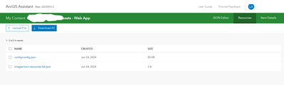

Use this AGOL Assistant:
AGOL Assistant: https://assistant.esri-ps.com/
Edit the config file, save and then publish from EB or edit both the config JSON and published JSON at the same time to match. The EB editor uses the JSON in the config file which is the same JSON in the published web experience.

As stated by MGEGIS, use ArcGIS Assistant: https://assistant.esri-ps.com/
(This is different than ArcGIS Online Assistant).
Only thing I would add and say here more explicitly is that you have to edit the json and then save it to a config.json file. From the link above, you can choose to then import and replace the file at the config/config.json directory for experience builder.

Thanks for the info!
I've been editing the config.json directly in the editor, but when I do that, my dynamic-data substitutions and some styling configurations get reset/removed.
By saving the config.json and then uploading it seems to fix that problem. Game changer for me!
