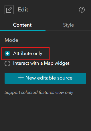

Hi @GeoFUNKE,
If users only need to edit the attributes of a feature, you can select 'Attribute only' when configuring the Edit widget:
You can then add any editable layers within your map as a new editable source. This will highlight the feature you are editing, but you will not be able to move or resize the feature. Therefore, there will be no orange box around it.
Hope this helps!
