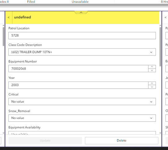

Anyone knows how do I control what goes into the title bar of the Edit widget tool?
Right now it shows as "undefined" and I do not see any option in the Experience Builder interface to change it.
I'm using Portal 11.3

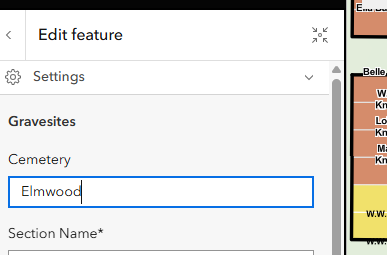

Portal or AGOL? This is what I see in AGOL & 11.2 portal
It looks like undefined is where edit or create features should be vs a title. I create my editing forms in map viewer using smart forms and you can set up titles, group names, etc.

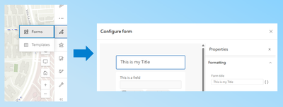

You can set the form title in Map Viewer.

Hi @doronwen
To add a form title in Map Viewer:
select the layer,
click Configure editing > Forms,
then set the Form title in the window that opens.

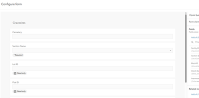

doronwen
I do not see that option in my form. My org is still using Enterprise 11.3.
I'm assuming that option is available in newer versions?
Laura
by MVP Regular Contributor
I have form titles in Enterprise 11.2
