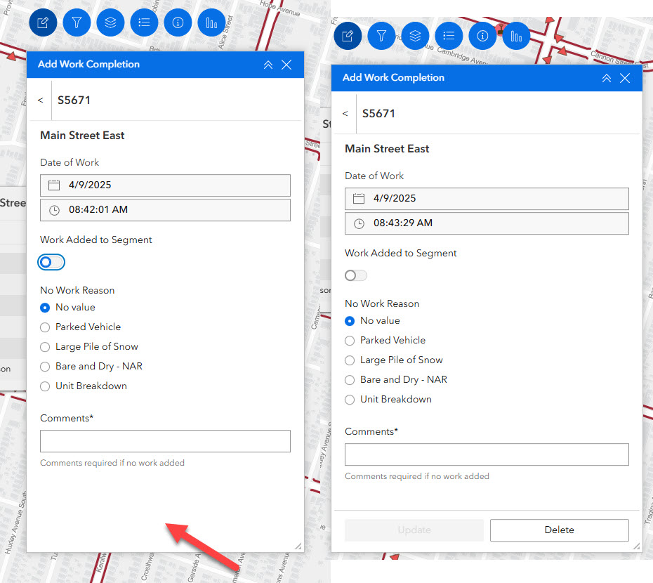

I have several Experience builder apps that are built around the edit widget operating in attribute only mode, with custom settings from the Field maps designer.
Starting sometime between Mar 7 and Mar 28, the Submit button in the edit widget window sometimes will go missing. Republishing the app will usually get the button to reappear but I can't keep republishing all my apps multiple times a day- am I missing something?

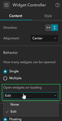

I encountered a similar issue like yours.
I guess the reason is that the edit in a controller does not load until it's opened.
You can try select the edit in the controller's "Open widgets on loading":

I find it intermittent.  It goes away.. comes back.. goes away again..  If you close out the widget and re-open it, they "may" appear.

I am experiencing the same issue ever since upgrading from 11.1 to 11.5
AaronMenza
Did you ever find a solution to this?  We're experiencing similar behavior in 11.5.
