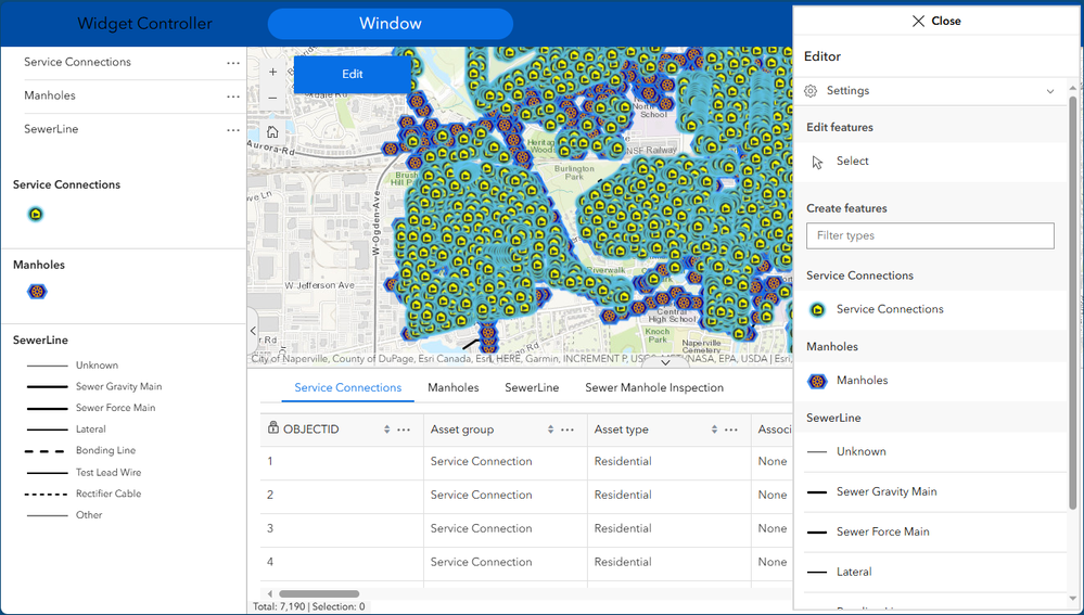

I have an experience with a map and 3 nested sidebars, one of which contains an Edit widget. When the sidebar containing the edit widget is collapsed and a feature is selected on the map the Edit widget automatically opens and pushes some content out of the screen. When this happens, the sidebar containing the edit widget is still considered 'collapsed' and can then be 'expanded' to fix the content pushed out of screen and then collapsed again to hide the Edit widget.
This behaviour is non-intuitive to me and I believe it is a bug. I have been unable to find other descriptions of this behaviour online and unable to find a fix through the widget settings.
Are there any known workarounds that would allow the Edit widget to remain hidden when selecting features on the map or tables? Users need to be able to add new features so the Edit widget must remain set to "Interact with a Map widget" rather than "Attribute only"
GIF of edit widget opening when selecting a feature on the mapGIF of edit widget opening when selecting a feature on the map

After looking into this further, Shengdi and the team were able to confirm that there is a bug. This will be fixed with our next release, which is usually around June.
In the meantime, there are some workaround options using a Button widget you may consider:
See sample: https://experience.arcgis.com/experience/642387537173411a939c2bf7dd469e08

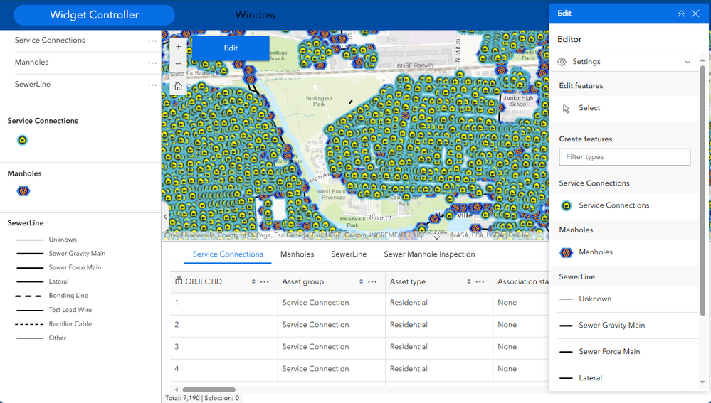

1. Place the Edit widget inside a Widget Controller and use a Button widget to open the Edit widget in the controller (setup a message action in the Button widget). You can hide the controller somewhere on the page (even behind the Button itself!) and use the Button to open the widget which may be more friendly to your users.
2. Place the Edit widget inside a window and again use a Button to open the window as a side panel.
For both of the options above, the Edit widget will only open when the button is clicked and will not open randomly when a feature is selected.

You could perhaps use the Feature Info widget in a Widget Controller to customize the display of popups? You can use a Message action to trigger the Feature Info widget to open from the Controller, as I described earlier with the Button. In this way, popups would display even when the Edit widget is loaded.
I added an example to the sample; click a feature in the map to observe. https://experience.arcgis.com/experience/642387537173411a939c2bf7dd469e08
Note: I turned popups OFF in the Map widget options, otherwise you may end up with 2 popups displaying in some cases.
