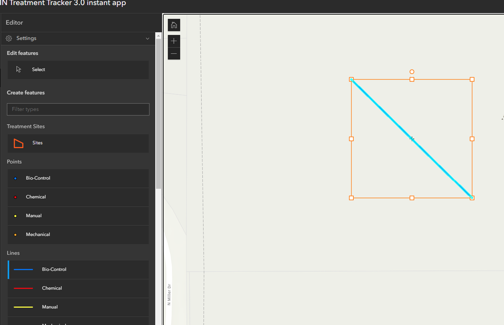

I am also experiencing this issue with a Sidebar instant app.
After discovering this with the Sidebar app, I created a new webmap for both the Sidebar app and Experience Builder to use and I continue to experience the same issue where features are being created visually but the smart form is not showing up and thus the feature is not actually being saved.

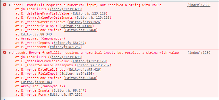

Error received when creating the features that the smart form does not appear:
