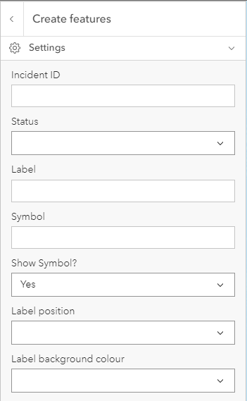

I'm wondering if someone can help me solve the puzzle of getting the default values for fields to populate in the edit widget when creating a new feature.

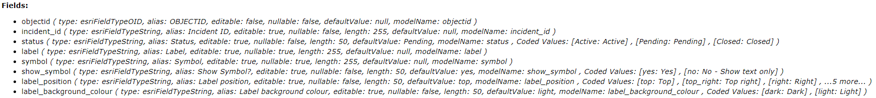

I have 4 fields setup in a feature service (AGS 10.9.1, data in enterprise geodatabase) with a domain and default value:
and I have added that layer to a webmap, then to ExB Dev Edition 1.11 Edit widget.
When I create a new point, it only applies the default value for one of the 4 fields:
I can't see a reason why that one is set and the others aren't.
Any ideas?
