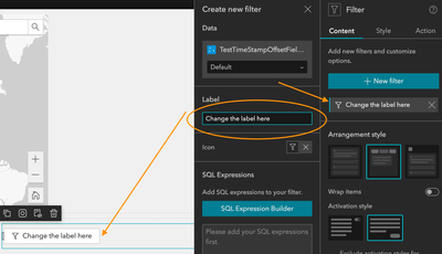

TonghuiMing
To change label
The background color for filter buttons cannot be customized at this time, unfortunately. It only shows light or dark depending on the theme choices.
GarySchells
Thank you for the reply.  That is unfortunate.  Can the text be customized beyond choosing what you want to call it?
TonghuiMing
For the Filter widget, the 'Label' input shown in the screenshot is the designated place to change labels.
Besides, you can change the data source layer label on the left-side Data panel as well, which will be reflected on the filter items using that layer.
