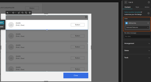

I have a list widget connected to the default data view of some waterbodies (table 1) data. The waterbodies each have a GUID, and I have a related table with information (advisories, table 2) about the waterbodies (connected by the GUID). In the list widget, under "States," I've set a link to a window I created that has a list of the related features. In order to see just the related features in the window when I click on a waterbody, I need to either filter them or select them.

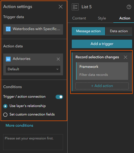

To filter, add a message action saying that when you select something from the table 1 list, filter the action data (table 2; note that the data view has to be the same as the one you're using in your window--this seems to trip a lot of people up).
Result:

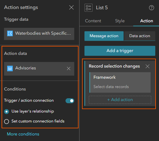

If you'd rather select the table 2 features, change what happens when you select a table 1 record, but...
Also remember that your window/table 2 data has to then be using the selected data view:
