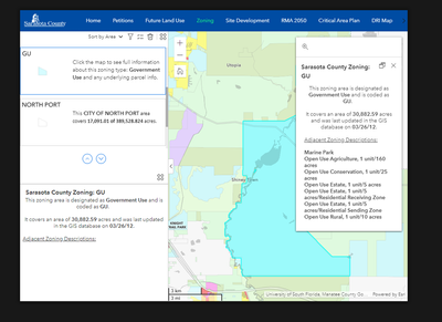

Hello - the Feature Info widget does not seem to honor arcade expressions that use the $feature type.  I am buffering a feature to return info as a list about bordering or coincident features (like zoning types that border a adjacent zoning poly), but the Feature Info widget will not bring up my list.  The map viewer popup returns the arcade just fine.

Update: Here is an example:
The Adjacent Zoning Descriptions is a list generated by buffering the feature and returning the features that intersect the buffer as a list.
Why wouldn't the Feature Info widget return the Arcade-generated list the same as the Map Info window??
It would seem to me that the Feature Info Widget would certainly recognize the $feature profile that is being used.

So it turns out that the Feature Info Widget DOES display complex Arcade expressions as part of the display, but only for small datasets.  I do not know what the limit is, but it is certainly less than the 2500 zoning records that I am working with.

Where I am getting at coincident polygons to return information on them (but not the selected polygon, and I have to pre-filter out super-complex large polygons that absolutely kill the return time) -
works just fine in the map.  BUT: for the Feature Info in EB, if I want a return there is some limit on how many records are in the feature set that can display in a list like I show above.
I don't know what that limit is, but it is less than 2000.  Maybe this can be addressed for the Online version at some point?
Otherwise, maybe there is some fetch limit or something in EB Dev Feature Info that can be bumped up somewhere?
