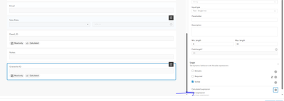

Regarding calculated expressions, I use them in both AGOL and Portal as well. As mentioned earlier, this configuration isn’t done in Experience Builder; it’s handled within the smart forms of the layer in Map Viewer. https://doc.arcgis.com/en/arcgis-online/create-maps/create-form-mv.htm

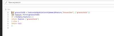

Here is an example of how I pull a unique ID from my layer into my table when a new record is created:
