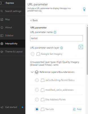

Just figured out this can be done in an instant app, which is what I ended up doing...using the same base webmap that is operating in my exp builder.  You can set a custom parameter, and carry it over from your third party software.  At that point you can dig into the search settings and adjust the behavior further:
In this case I just added '&taxlot=[number passed in from other software]' to the end of my link.
