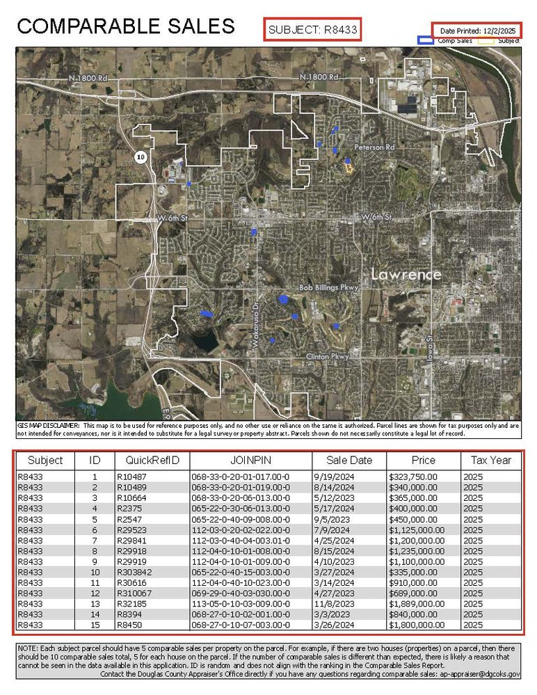

I did meet with Esri Support and they think the issue is in the Arcade expression used in the dynamic text. The goal is for the layout to populate with ~2-15 records from a single layer in the web map based on a user-input filter. This is an example of the ideal output, where all of the red boxes (dynamic text boxes) are populated correctly.
An example of the second and third layouts. The red boxes are not part of the layout.An example of the second and third layouts. The red boxes are not part of the layout.
I've had three different layouts work at least once then stop working with the print service. For all three of these different layouts, the dynamic text was built from the Table Attribute: Value option. I've tried in-/excluding the CIMPATH for the mapMemberUri, making the field value lowercase, and removing all layers or just the referenced layers.  I haven't noticed a major difference from any of those changes, or at least any that resulted in successful printing.
