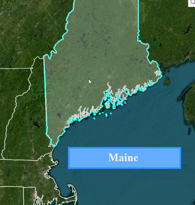

Hello! Could someone please tell me how to apply dynamic content to the text widget so when the user selects a polygon from the map (in my case a state boundary), data about that polygon appears? For example, if I click on the state of Illinois on the map, I want the "State Name" of "Illinois" to show up on the right. And if I decide I don't want Illinois, but Indiana, when I click Indiana on the map, the name on the right shows up as "Indiana."

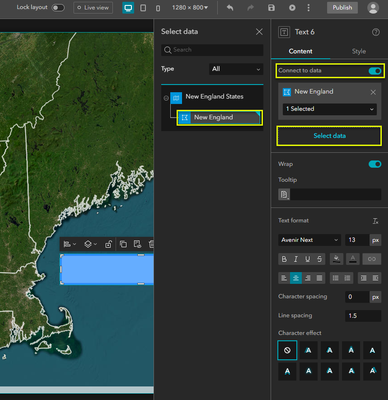

At the top of the Text widget's settings you have this Connect to data switch. Turn that on, then click Select data and choose the layer(s) you want to use to populate text.

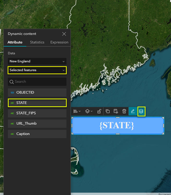

Once you have a layer connected then you can go to the widget's toolbar and see that the Dynamic content button is available. Click that to open the Dynamic content panel, where you can add attributes and expressions as text.
What you'll want to do, like I've done here, is make sure your data is set to Selected features and add whichever attribute contains the state names. When the user clicks on Illinois the text will update to say "Illinois".
