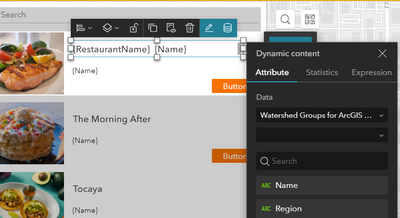

This seems like such a simple issue but it isn't working and I don't understand what I'm doing wrong.
I'm using Experience Builder with the Jewelry box template. I can add the attribute value to the sidebar (so it is connecting with the data), but the actual information from the sheet doesn't show up.
I've had a similar issue in the past when I did Get started with ArcGIS Experience Builder: Fill an app template with your own data training. I could only get it to show the first bird for every block on the sidebar.
What am I doing wrong? How do I get it to dynamically list the data?
Thanks!

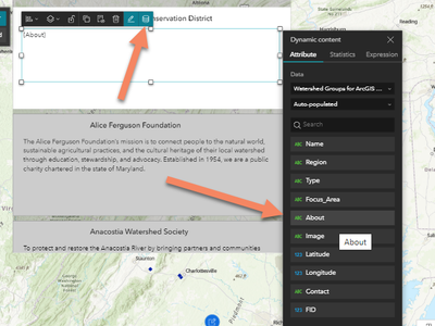

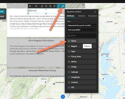

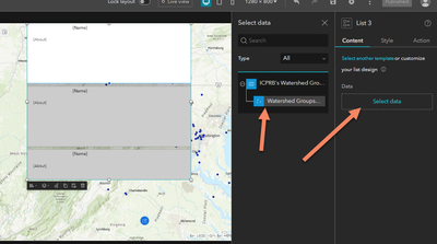

If I add a List widget, then Select data and point to the dataset:

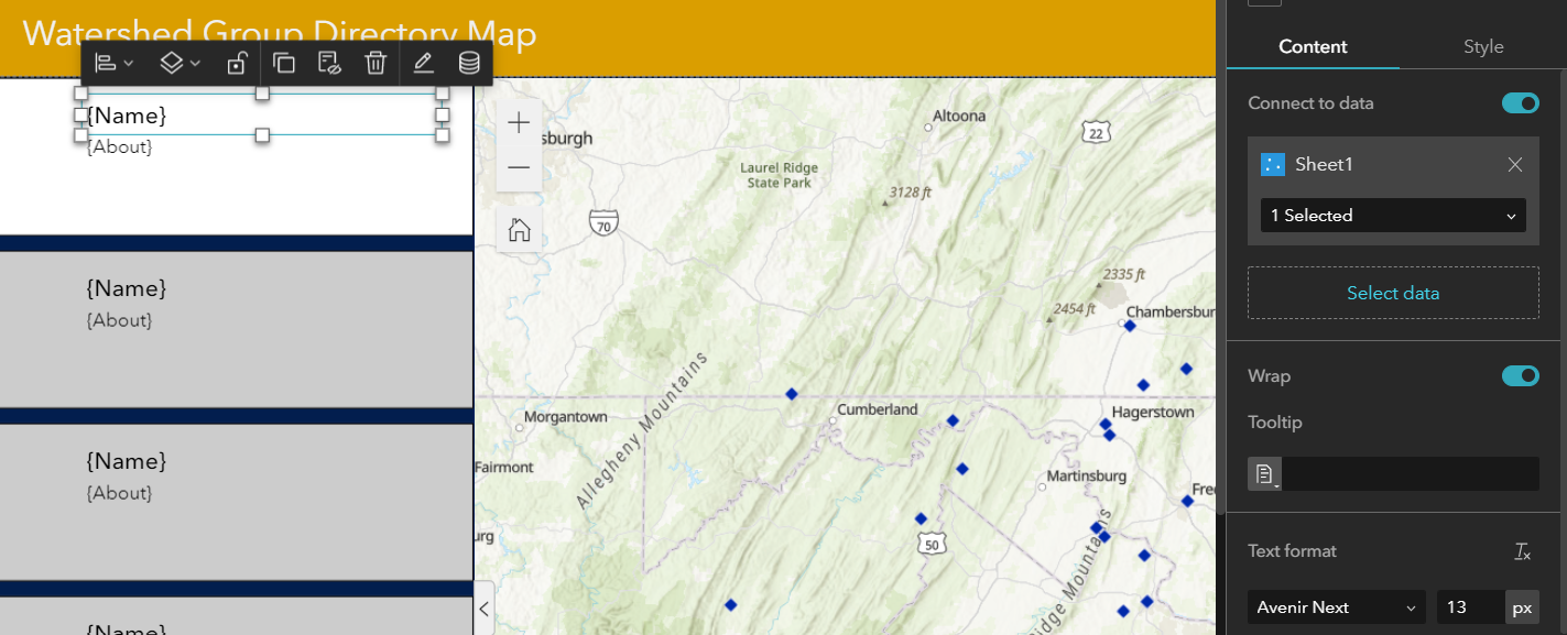

Then select one of the text box's in the list widget, and press the Dynamic content button and pick "Name" from the list of attributes (now that the widget is connected to the new datasourse):
Then click the other text box, Dynamic content button, "About" attribute field:
Then, when I select Live view, Preview, or publish/view the Experience, it is being populated with the attributes from the data.

It looks like you are using the List widget.
Once you have selected data, you need to configure each "box" in the widget so it knows what field to pull the data from dynamically.

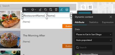

RenBou
I've used the Dynamic Content button, but it doesn't seem to be connecting to my data.
For example, when I use the Place Explorer template with AGOL, the feature works fine. It shows me the "auto-populate" option.
But when I use my own data (or the Birding in Boston data) it doesn't give me that auto-populate option within the Dynamic Content button.

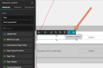

EJSlager_kcgis
I am also having issues with the Auto-Populated option not being available. Did you ever figure out why that option sometimes wasn't available? Anyone from Esri have an explanation for this?
