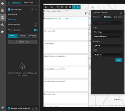

In the Data panel, go to the bottom and check the box for View For Empty Selection. In the Dynamic Content, set your data to Selected Features. This should make the number display the total count with no selection and the selected features count when selected. If you want to change the text around the number, I think you will need a custom widget.

Wow, so simple. I can't thank you enough. I can't believe I missed that. I was expecting such an option to be under the widget settings. Thanks again!

Hi! Literally doing the same currently but it's showing an inaccurate count for all. You can see in the table that number should be over 62,000 and not 100. The total values are correct and will change according to selection. The parcel count will only show correctly when I change the expression to just default. Any suggestions?
(Ignore the font differences. I'm just going back and forth between expressions before I commit lol.)
