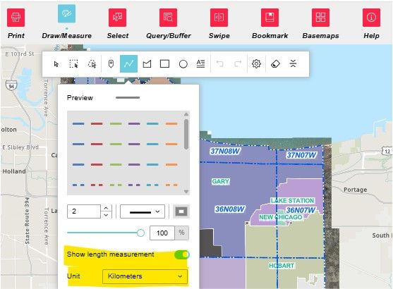

I noticed in your widget there is an option to select the unit of measurement as when I used the tool it was in km
MattCashen
@DanielFox1  Hi Daniel.  As I mentioned above I think David figured out what was happening.  The setting you are referring to only applies when a drawing is completed.  So if you set it to Kilometers it will show the measurement length in kilometers on the map after you finish your drawing.  This setting doesn't apply to the gray tooltip box that moves around with your cursor.  And this probably should be changed because it is a confusing setup for these two things to not be related.
