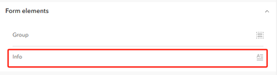

Thanks for your post! The warning dialog popup is intended behavior, as the calculated expression modifies the field value each time a feature is selected, and the edits remain unsaved. In this case, we recommend avoiding the use of Arcade to update field values. Instead, if you’d like to display certain information, such as a username or date, you can use Smart Forms and place the expression in an info form element.
