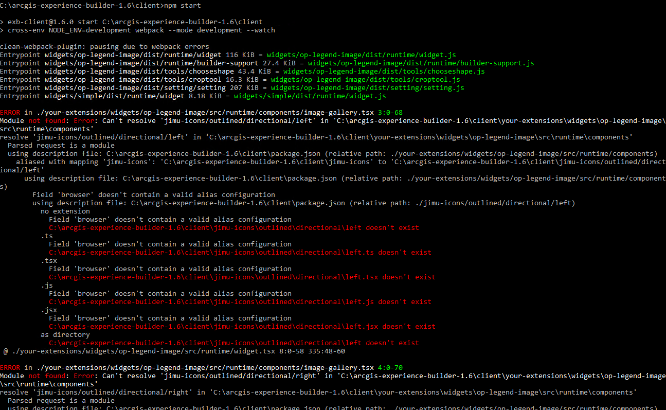

I tried simply copying the Image widget to client\your-extensions\widgets and renaming it and got these error when in ran the client:

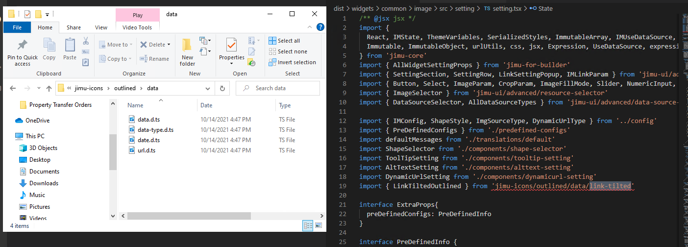

It seems that a file is missing in the client\jimu-icons\outlined\data folder:

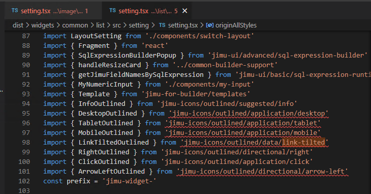

I happened to see that in the List widget there seem to be more files missing:

I am seeing this behavior too. We'll check into it. Thank you for the report.
Dvirus
Hi,
Same issue here.. Its appear that missing files.
