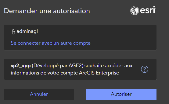

then an SAML login page asking for a permission

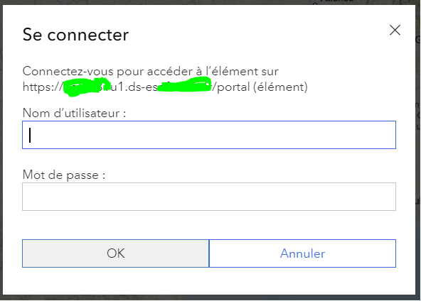

At this point the experience is not really user-friendly, but it seems to work ... the problem is that a 4th (!!!!) form is showing up at the same time and asking for a user and a password on portal1, bypassing SAML Option (although internal login is disabled on Portal1).
If i dismiss this form , the ArcGIS Server 1 Layer is not in my app ... if I create an internal login and us it, it works...
in fact the third form was the rigtht one, but it doesnt have any effect. the 4th came simultaneously, ad it seems that the app uses the wrong one...
