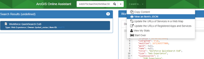

Now get that downloaded .zip that you extracted from AGOL using ArcGISOnline Assistant
  • make sure you get the 'Description' and the "Data" paragraphs (scroll down further)
  • save the description as agol_44b979c9ae09xxxxx2301a2e07e_description.txt
  • save the data as "config.json"

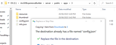

  • now copy this "config.json" into c:\arcgisExperienceBuiler\server\public\apps\0
  • Copy the exact same file also in this location:   (don't know why - it exists in 2 locations) C:\ArcGISExperienceBuilder\server\public\apps\0\resources\config
  • Now refresh your Experience Builder Dev edition :3001
    and VOILA! you have imported your AGOL Experience into your Local ExB Dev Edition.

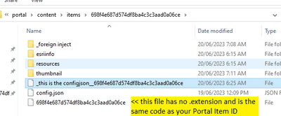

  • create a dummy ExB with your Portal
  • get the PortalItemID  (see URL when you edit)
  • find your portal install folder with all the itemIDs   \portal\content\items\
    There are thousands of sub-folder named the same as all the existing Portal itemIDs
  • Open the folder that matches exactly the dummy ExB you just created (above) with your Enterprise Portal
  • in there there is another single file also called the same code as the ExBPortalItemID , a file with no extension:
  • That is actually the same as a config.json ,  so copy your own config.json in there,  then rename your config.json to substitute that file
  • Reload your Portal Experience Builder item : VOILA! you have surgically injected from the Dev Edition into your Enterprise Portal.

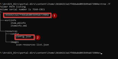

AzinSharaf
thanks for posting this. It seems there is a minor change in 11.3. I had to copy the config.json to a different folder in addition of the one you have mentioned in the post.
FredericPoliart_EsriAU
new ArcGIS Online Assistant   https://assistant.esri-ps.com/signin
On this new site, you can "copy item" and specify TWO arcgis Online (or portal) accounts.
worth a try.
